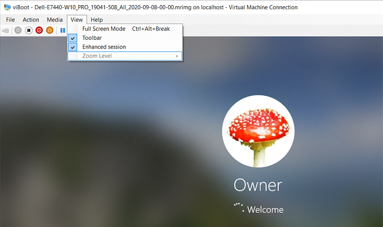

    Is the image you are using in viBoot an image of a W10 Home system or W10 Pro? Was the image of a Legacy bios/MBR machine or a UEFI/GPT one? The availability (or otherwise) of enhanced session mode depends on which you have used.
    Testing this, for my Legacy/MBR images viBoot creates a Generation 1 machine, for a UEFI/GPT image it's Generation 2. For a Generation 1 VM enhanced session mode is not available for W10 Home as the guest OS, it's available if the guest OS is W10 Pro.
    Turn On or Off Hyper-V Enhanced Session Mode in Windows 10
    It makes no difference whether the VM was created by the Hyper-V manager or by viBoot. It's the combination of machine generation and guest OS that determines if enhanced session mode is available. Here's an example of a viBoot VM where it is (Gen. 2, W10 Pro).
    [OS Build: 17763.3650] Windows VM does not boot when EIM enhanced interrupt mode is "on" 298988d1601056014t-enhanced-session-mode-question-image.png
