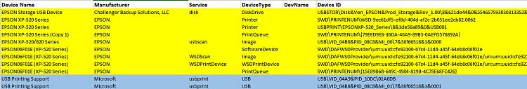

    I took a snapshot of and highlighted the rows of interest in DevManView
    It shows Epson drivers installed. It also shows USB Printing Support drivers installed (the second of the two USB Print Support rows is for your Epson printer). But it also says the printer wasn't detected at the time you ran the tool. Sorry, I forgot to have you turn on printer on before running the report. Sorry.
    Could you please run again with printer turned on?
    1. When you turn printer on/off are you hearing the USB connect/disconnect "ding-dong" sounds?
    2. Open Device Manager. Show hidden devices.
      • Anything change under the Printer or USB Categories as you turn printer on/off
      • When you turn the printer on, do you see an Unknown Device under USB?
