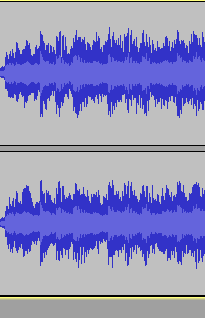

    Excellent reply. I set Audacity as you suggest and it works. To my perfectionist mind, there's one flaw: with all volumes to max, the recording level is rather low, as the attached snip shows. Any ideas how to increase it? My previous Win 7 laptop allowed far more level than this, using a Realtek driver.
    PC audio is going through mic input 158745d1508329696t-cant-isolate-line-audio-mic-input-audio-driver-not-showing-audacity-meter.png
    Airlane1979, Mar 13, 2023
