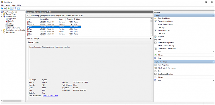

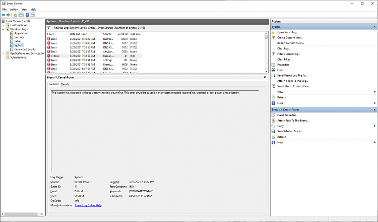

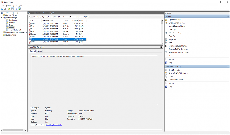

    Hey there, I hope someone can give me with my situation:
    Since a long time now (about 6 months now), I'm getting BSOD "WHEA_UNCORRECTABLE_ERROR" while playing GPU intensive games (most time Rust from Steam). My Computes is a custom build by me. The BSOD sometimes occurs like a minute after I've started the game (and joined a server) and sometimes after a few hours of playing. The weird thing is that it doesn't write any logs / dump files under (C:\Windows or C:\Windows\Minidumps). So I'm not really able to check what the problem is.
    My Windows Version: Microsoft Windows 10 Professional (x64) Build 19041.867 (2004/May 2020 Update)
    I've included the V2 log collector file and a HWiNFO64 report below. Please note that there could be some harddisk errors in the logs - "The device, \Device\Harddisk1\DR7, has a bad block.". Those entries come from a bad external drive I've connected some days ago, but I've removed it and the BSOD occurs also without it):
    DESKTOP-VF02TM2-(2021-03-23_21-40-50).zipDESKTOP-VF02TM2-HWiNFO64.zip
    Those entries are generated in the eventviewer each time the BSOD appears:
    Pc is having BSOD crashes while gaming and randomly getting critical hardware errors in... 324277d1616533912t-bsod-whea_uncorrectable_error-randomly-while-gaming-no-error-logs-log1.png
    Pc is having BSOD crashes while gaming and randomly getting critical hardware errors in... 324279d1616533912t-bsod-whea_uncorrectable_error-randomly-while-gaming-no-error-logs-log5.png
    Pc is having BSOD crashes while gaming and randomly getting critical hardware errors in... 324281d1616534084t-bsod-whea_uncorrectable_error-randomly-while-gaming-no-error-logs-log7.png
    Those are the things I've already checked:
