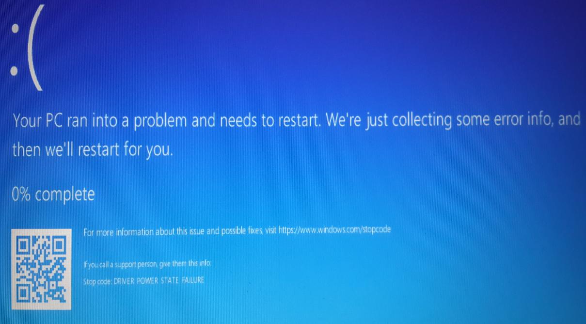

    Suddenly, I run into the blue screen. I wait long but it is stuck at 0% Complete. I restart manually. Restart takes maybe 15 to 20 minutes. Then I receive a login screen with no input field for password! I restart again, this time it's faster. I get a login screen WITH a password field. I login and opening any application takes 2 to 3 minutes.
    As suggested by the accepted answer, probably I'm going to totally replace this OS =(
