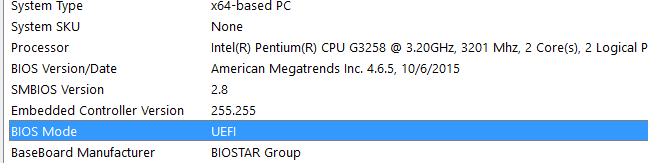

    I don't think I can enable CSM for my motherboard without running into errors eventually, it just does not seem to like having uefi with csm on strangely. So everything went smoothly for your uefi install with CSM? By now I would thought uefi and uefi drivers would be the default option and legacy bios have its death but it does not seem like it.
    Edit : Is this shown Uefi on your windows?

    To make Windows show UEFI as bios mode you need your Z97 Pro Gamer in "Pure UEFI" mode (ie CSM = OFF). Windows IIRC only changes between legacy / UEFI on install, so even if you change to CSM=Off it may not show UEFI bios mode in Windows system info tool. I have not had 2 GPUs in a system at one time, even if I had them, I thought my PSU was not up to the job, so can not comment if only the primary display card requires UEFI module and it is irrelevant if secondary GPU does not.
    If you get black screen/issue after setting CSM off then remove the card with legacy ROM, if mobo boots then you'll know you need to update the ROM on that card.
