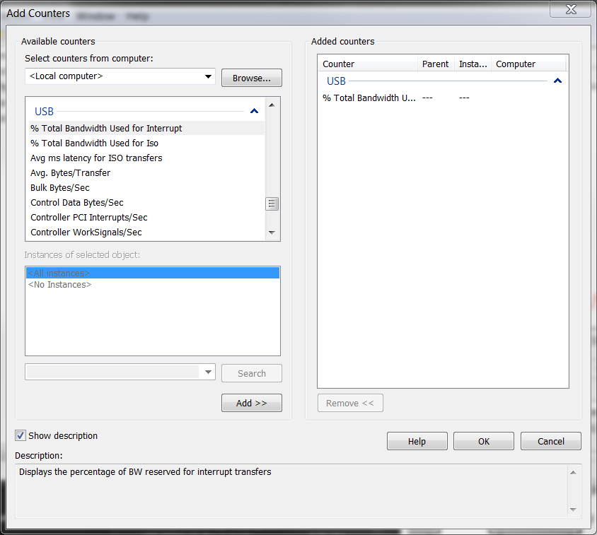

  3. Unselectable and Disappearing Counters in Performance Monitor / Perfmon.exe
    Computer: Dell Latitude 7480
    Program: Perfmon.exe (32 bit and 64 bit)
    OS: Windows 7, Widows 10
    I am trying to add counters for USB in Performance Monitor. I want to do something similar to this:
    In the screen-shot, I use % total bandwidth used for Interrupt as an example, but this applies to any counter with a grayed out/ unselectable
    <All instances> instance.
    When add >> is selected it seems to add the counter, but once you select
    OK, the counter disappears. It does not show up in Perfmon and does not show up in
    Properties -> Data. It's almost as if I never added it.
    I have quite a few internal and external USB hubs, and USB devices on this computer, so I'm not sure why there are no instances to select. Maybe that is a clue? Is there something I have to enable first?
    There isn't good documentation describing what the grayed out <All instances> means, can anyone please explain? Even if it is alone in the list,
    <All instances> is sometimes gray and sometimes not. For me,
    Thread
    counters only have <All instances> but it is not grayed out, while the
    USB counters have <All instances> but are grayed out. Also not sure what is different between a blank
    Instances of selected object: list and a grayed out out Instances of selected object:
    list is.
    Additionally, can anyone help me monitor/ enable the USB counters?
    Thank you in advance!
