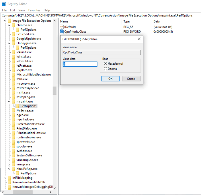

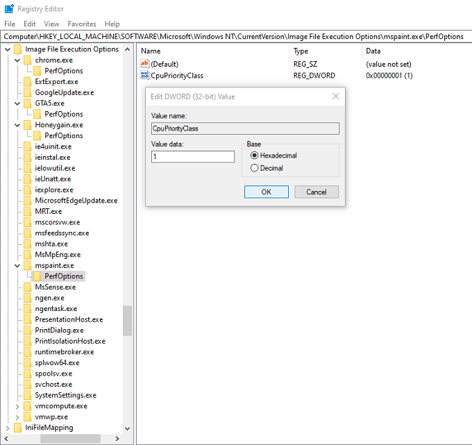

    1. Open Task Manager and click on the Details tab then select program.exe.
    Permanently setting Priority Processes Using Registry Editor does not work for "NVIDIA... d6bad212-b114-467a-bacd-899ffe5d1b3f?upload=true.png

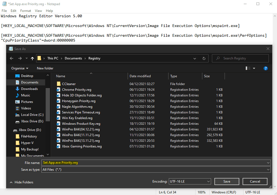

    2. Open a new Text Document and copy & paste this registry command.
    Windows Registry Editor Version 5.00
    [HKEY_LOCAL_MACHINE\SOFTWARE\Microsoft\Windows NT\CurrentVersion\Image File Execution Options\PROGRAM.EXE]
    [HKEY_LOCAL_MACHINE\SOFTWARE\Microsoft\Windows NT\CurrentVersion\Image File Execution Options\PROGRAM.EXE\PerfOptions]
    "CpuPriorityClass"=dwordPermanently setting Priority Processes Using Registry Editor does not work for "NVIDIA... :pRIORITY
    3. You need to replace the PROGRAM.EXE to your application and change the PRIORITY to a hex value.

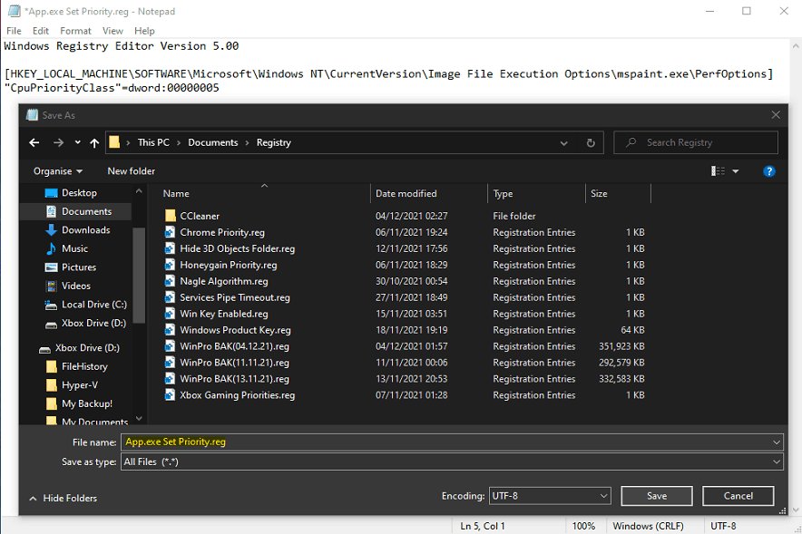

    4. Save the text document as a .reg extension file.
    Permanently setting Priority Processes Using Registry Editor does not work for "NVIDIA... ffc2bfc0-6c95-4854-ac9a-ec7f047d0cd0?upload=true.png

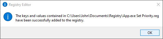

    5. Double-click on the reg file and click Yes, then click Ok.

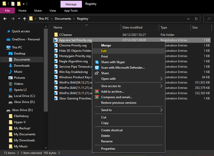

    6. Right-click on the registry file to modify, and select Edit.
    Permanently setting Priority Processes Using Registry Editor does not work for "NVIDIA... 63b5ada5-8981-41c7-aa96-f4ce74d90498?upload=true.png

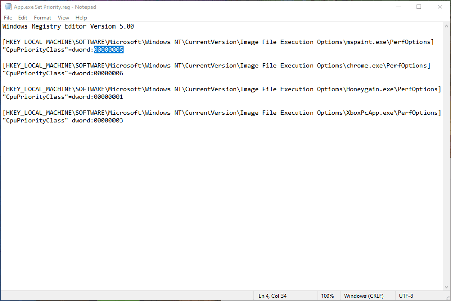

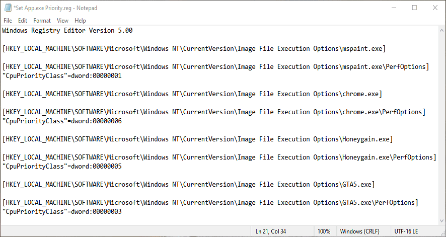

    7. You can add more applications below the next registry command.
    Permanently setting Priority Processes Using Registry Editor does not work for "NVIDIA... f1b90ee3-9c8b-47e9-8d64-2068a3576f45?upload=true.png

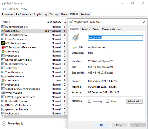

    8. Now, if you wish to change the application priority or delete the exe reg folder and revert back to default, then need to restart Windows.
