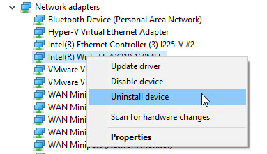

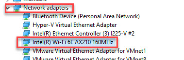

    2) Locate the WiFi Adapter in device manager:
    Persistent Intel AC 9650 code 10 glitch makes it impossible to use my laptop, any permanent... 340097d1625873909t-intell-r-wireless-ac-9560-160mhz-cannot-start-code-10-a-image1.jpg
    NOTES: My WiFi adapter has a different name than yours because this particular machine has a different module installed.

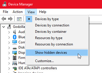

    If the device does not show up in Device Manager, try enabling the display of hidden devices like this:

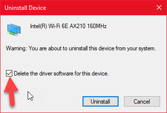

    3) Right-click and select the option to uninstall the device. Make sure to delete the driver as shown below.
    Persistent Intel AC 9650 code 10 glitch makes it impossible to use my laptop, any permanent... 340099d1625874045t-intell-r-wireless-ac-9560-160mhz-cannot-start-code-10-a-image3.jpg
    Persistent Intel AC 9650 code 10 glitch makes it impossible to use my laptop, any permanent... 340100d1625874093t-intell-r-wireless-ac-9560-160mhz-cannot-start-code-10-a-image4.jpg
    4) After uninstalling, install the two drivers you downloaded.
    5) You will need to rejoin your wireless network.
