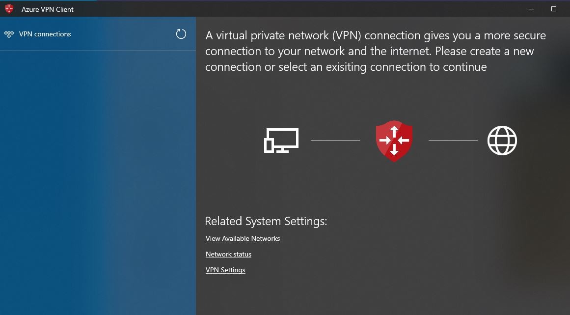

  2. Azure VPN client connections drop frequently
    Dear All,
    Hope you're well and wondering if you could advise or guide me to the right direction for below :
    At our organization, we have moved our VPN connection method from Pulse Secure VPN to Azure VPN client connection, Found that Azure VPN client connection drops frequently & require to reconnect again although users are connecting their laptops with multiple ISP provider ( ISP are Telstra, Optus, TPG, etc.). If laptops are connected to Pulse Secure VPN app with the same ISP, don't see any disconnection or drops. Disconnection appeared only when laptop is connected to Azure VPN. IT support said that, Azure VPN is very sensitive & if it's sees any disconnection/drops from router/Wi-Fi hotspot, Azure VPN disconnects as well. But we don't see any disconnections when connected to Pulse VPN. Wondering if you could advise how we can fix this disconnection issue.
    Thanks in Advance.
    Ping latency connecting across azure vpn. We have verify ISP connection is solid. 20d76d6c-02e7-46ec-9d59-5d263d1f6f94?upload=true.jpg
    Monsur Alam Chy, Oct 6, 2023
