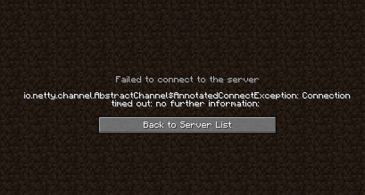

    I have gone through absolutely everything I can find. I've allowed firewall access, I've double checked possible typos, and yet I still for the life of me figure out why port 25565 is not open. I've been trying to get a MC server going for hours at this point and now considering giving up. Yes the server runs, no there are no typos, yes it is the correct internal IP, yes it is the correct port, yes I am connected to the internet, and yes I've allowed the port through the firewall with both TCP and UDP. Every single forum and discussion I've found so far ended with the user making a typo or no

    Also I don't know if this helps but this is the error I get when trying to load into the server on a different WIFI.
    Port 25565 still not forwarded 302117d1602866491t-help-port-forwarding-will-not-work-picklesmpfailedloading-screen.png
    - - - Updated - - -
    Ok so I checked my external address with the 25565 port on a port checker which it said it was open but my server ip address with 25565 was not open so I asked my friend if he could join the server with my external address and he could!! I don't know why its working now maybe because I got rid of the port forwarding rule and ip reservation and then put it back but I did that before and it did nothing.
    BluePickle151, May 10, 2025
