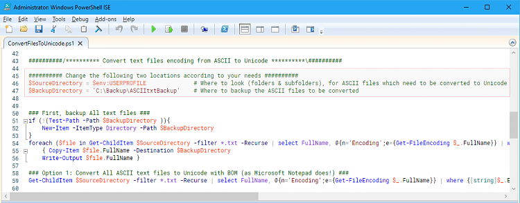

    Important Note:
    If you want to change either the backup location or the folders where the ANSI text files reside (e.g. search all C:\), open the script “ConvertFilesToUnicode.ps1” and as shown in the red box, in the image below, go to the section where we define the locations and change them according to your needs (e.g. $SourceDirectory = ‘C:\Personal\My Files’). Don’t forget to enclose the folder in quotes (e.g. ‘C:\Backup\My ASCII files’).
    PowerShell 5.1 Parser Bug: Failure to Parse UTF-8 No BOM Script Containing Unicode Characters 189644d1526896161t-unreadable-non-ansi-characters-notepad-directories.png
    For Advanced Users
    Microsoft Notepad, saves all Unicode files with BOM (Byte Order Mark). In case you don’t want to use BOM in your Unicode text files, use the “ConvertFilesToUnicode_NoBOM.ps1”. It will do exactly what the “ConvertFilesToUnicode.ps1” does, but instead it will save the text file in any Unicode encoding without the BOM.
