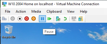

    No sleep options on Hyper-V
    Do you have a specific need to have sleep available in a VM, or is your question just out of curiosity? If you just want to suspend its activity, then 'restore down' to have the VM connection in a window on your host machine. Then Pause is available in the Action menu and on the toolbar.
    Preventing system sleep ONLY while Hyper-V VM is running 331278d1620164760t-no-sleep-options-hyper-v-hyper-v-pause.png
    If you specifically need sleep/hibernate for test purposes then no, neither sleep or hibernation are available to the guest OS in a Hyper-V VM. It is possible to enable hibernation for a Hyper-V VM though....
