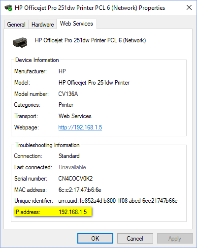

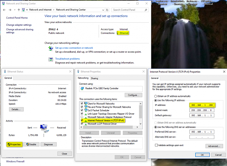

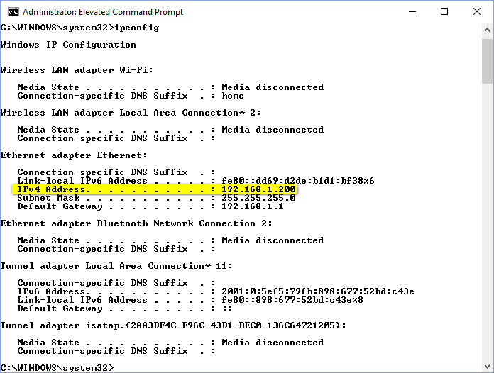

    I set the IPv4 address to 192.168.1.200
    ipconfig shows it as 192.168.1.200
    The printer still shows 192.168.1.5
    What did I do wrong?

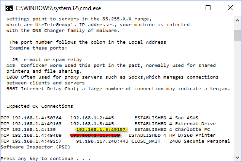

    additional information
    The address assigned to the printer, 192.168.1.5 is shown as belonging to another computer (Charlotte) on the local network.
    See Netstat below
    Printer goes offline after reboot - Every danged time! 91296d1485969525t-printer-goes-offline-printer-ip.png
    Netstat:
    Printer goes offline after reboot - Every danged time! 91297d1485969525t-printer-goes-offline-ip-address.png
    The D7260 printer no longer exists. I will try to delete this assignment from the router
