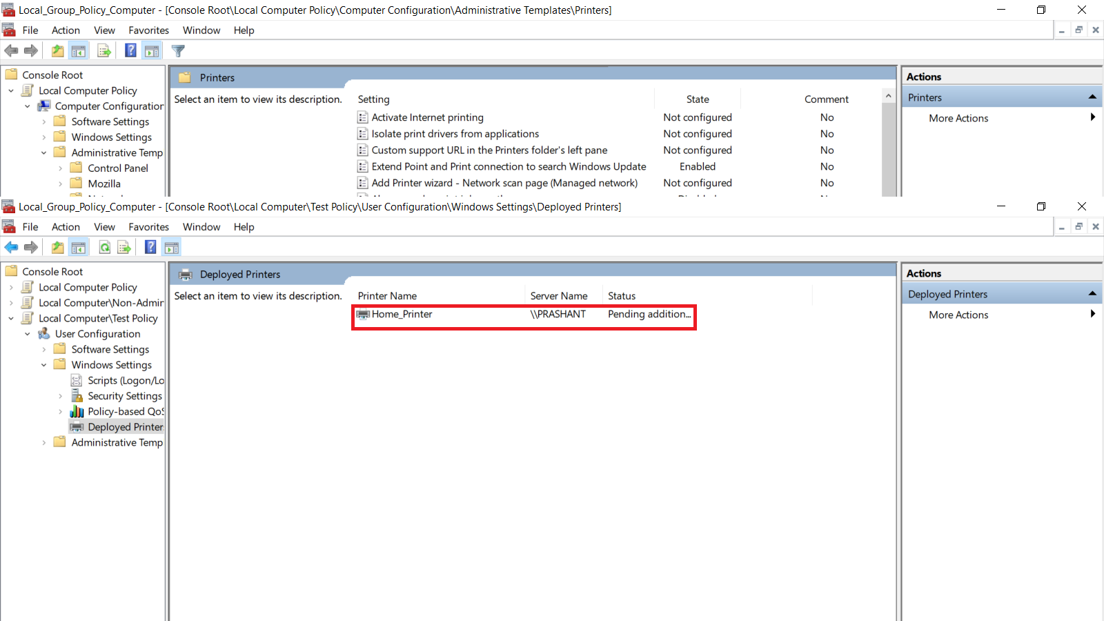

  2. Deploy Printer on network using local group policy (Windows 10 Pro Laptop)
    I am trying to deploy a printer that is connected to my laptop via USB. I am trying to use local group policy to accomplish this. I have done the following in the admin account:
    1) Connected the printer Cannon MG3500 to my laptop and installed the drivers.
    2) Shared this printer on my home network which is of type Private.
    3) I see the printer connected in my admin account.
    Now my laptop has three non-admin users; Test, Test1 and Test2. I want to deploy this printer only to Test and Test1 users. Test2 should not be able to install the printer drivers and use them.

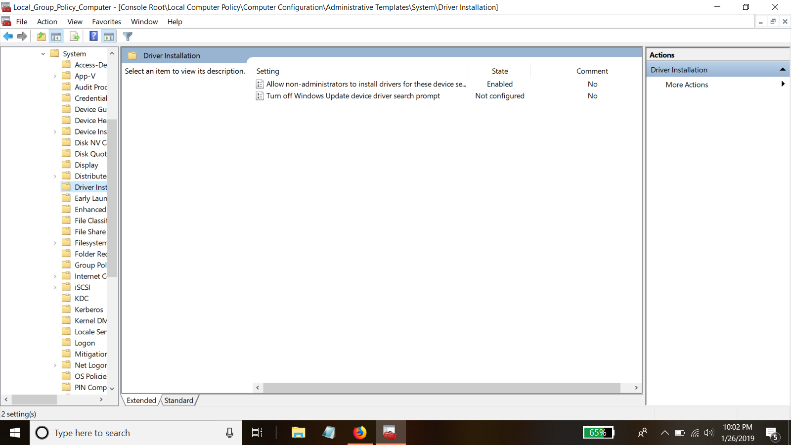

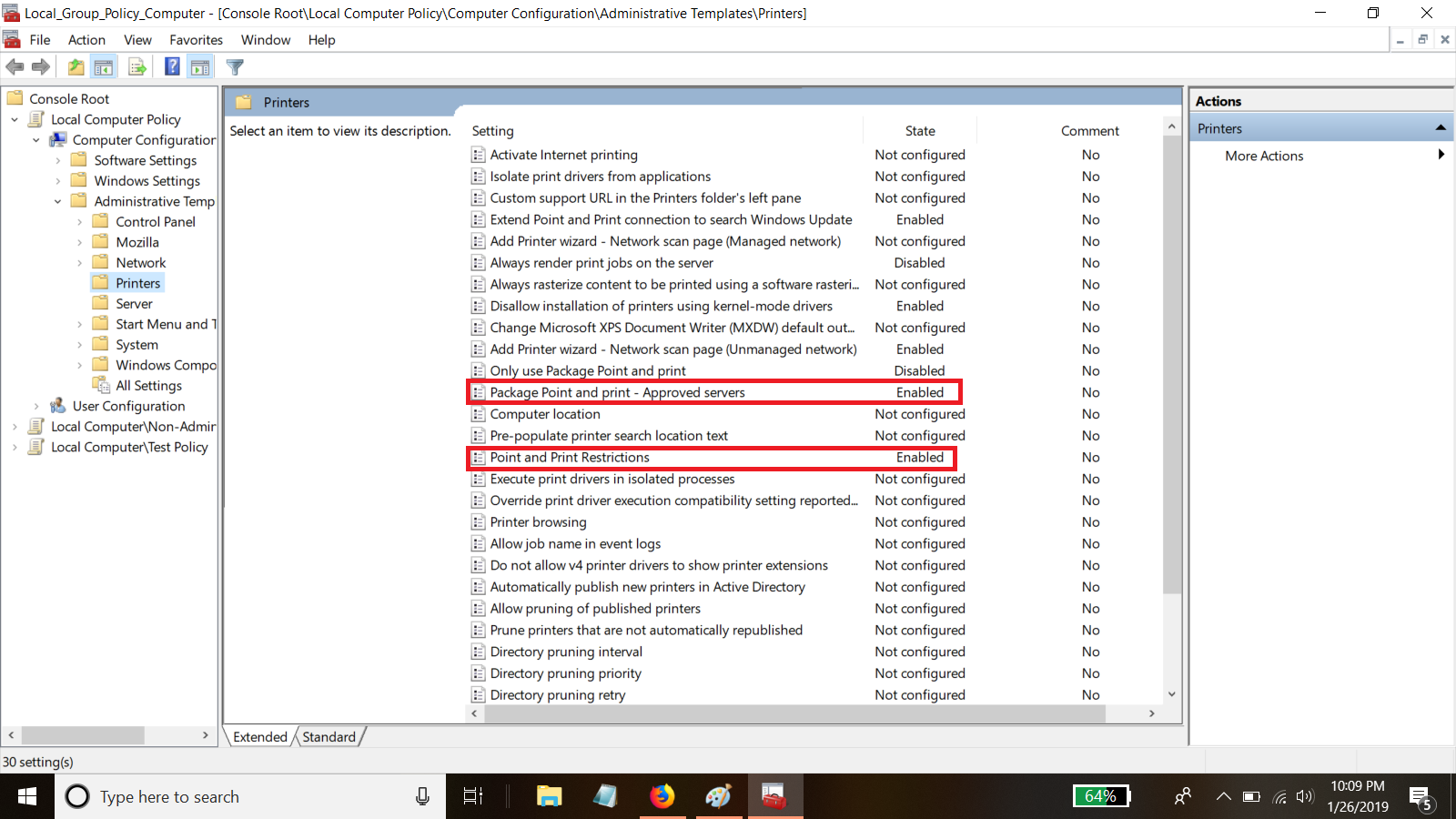

    Now, while logged in as admin, I open group policy editor and make sure that the following setting are enabled:
    Printers will not deploy to domain computers via group policy; printers can be installed... 243be3d5-99f1-4127-83a3-460966c3b1b7?upload=true.png
    Printers will not deploy to domain computers via group policy; printers can be installed... 6fb11886-b1b1-4298-93ce-e12020a750e5?upload=true.png
    In the approved servers I am defining the print server that I created on my laptop (\\x.x.x.x\printer_name)
    I verified that network discovery and file and printer sharing is turned on for private network.
    Now I can deploy the printer for the whole computer in the GPO local computer policy and the printer gets deployed, no problem.
    When I try to go deploy the printer in the GPO Local Computer\Test Policy (Test user policy) it always shows the printer status pending, I don't know why.
    Printers will not deploy to domain computers via group policy; printers can be installed... 416eb5f1-498d-444e-a61b-32e2a49e37f0?upload=true.png
    So does this mean that I can deploy the printer, I have to deploy it for the whole computer and cannot do it for specific users? (non-admin)
    Also I tried deploying the printer using print management, right-click on the printer and select deploy with group policy. This did not work as well.
    I am trying to do this on a laptop that is running Windows 10 Pro and is not connected to a DC.
    Can someone please help me with my dilemma ?
    Thank you
    Prashant Desai
    PrashantDesaiHN, Nov 17, 2021

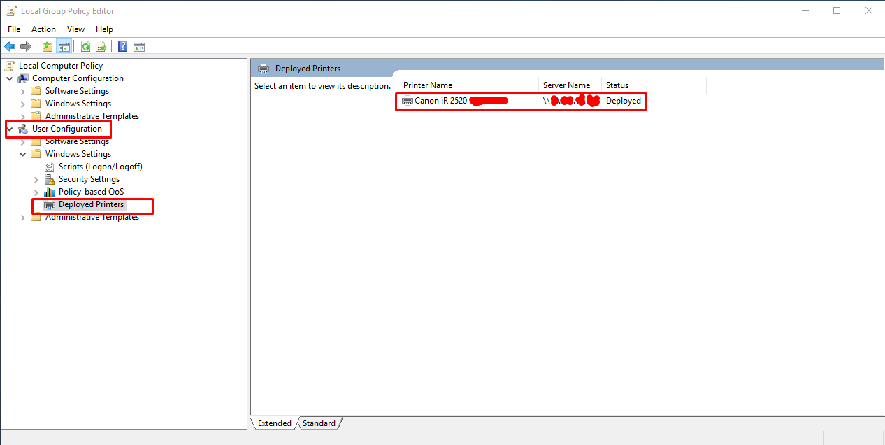

  3. Gontrop Win User
    Adding a network printer with Local Group Policy Editor to the User Configuration
    Hello all,
    Ambience:
    I work in a place that has a print server, with some network printers installed.
    Normally we install printers in the users PC's accessing to the Local Group Policy Editor and adding the printer to the "User Configuration>Windows Settings>Deployed Printers".
    This ambience gives us the freedom to, in case a user requests to have a different printer on his PC, to access to the PC to the LGP Editor remotely and add the printer.
    Problem:
    The problem is that if we decide to deploy a different printer to a list of computers we can do it remotely but only one by one.
    Request:
    So, I've decided to ask if any of you know a way to remotely add a printer to a remote computer, doing it by policy but with a command or something similar.
    If we can do it this way it will allow us to deploy on multiple computers running a script.
    I can insert a picture of the Local Group Policy Editor place where we add printers.
    Printers will not deploy to domain computers via group policy; printers can be installed... f4732bb3-59c6-4f65-a1e6-b87172672a3a?upload=true.png
    Thank you in advance to all
    Gontrop, Nov 17, 2021
