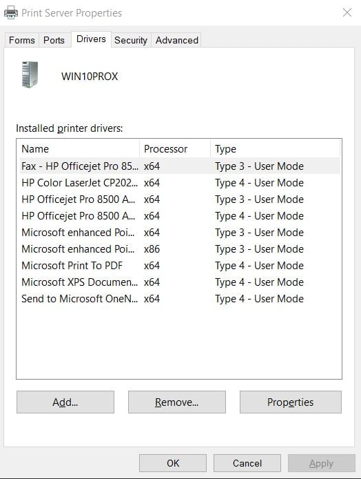

    I encountered this problem with HP Envy 5530 recently. The printer was working in wifi mode after initial Windows 10 upgrade. Three days later, it would not print.
    We figured this is printer upgrade problem. So we downloaded the latest version of printer driver. It recognize the IP address, printer model but on install the printer driver software it failed. I plugged in the USB printer cable and changed the port from wireless to USB and it started to print. This worked for two days and failed again.
    Run HP diagnostic test and no help. This is how I fix this problem:
    1. Start - Run or Win+r - type "printui /s /t2" and open the program
    2. You should be on the "Drivers" tab
    3. Remove all Hp printer drivers from old (and current) installs
    You may have a different kind of box appear after running printui /s /t2 but basically it's just a case or removing the old driver.
    Print Management can also be found in Control Panel > Administrative tools > PrintManagement in Pro versions of Windows.
    Retry the installation and the printer software driver installed without any problem.
    This is just a captured for the printer server properties not the HP Envy 5530 model for illustrative purpose only:
    Printing issues - Just built Windows 11 PC and HP envy 5530 printer 59043d1485961988t-hp-envy-5530-printer-software-wont-install-printer-server.jpg
    Printer Server Properties
    Good luck, ChristineL!
