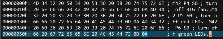

    I am using Repetier-Host for 3D printing. Configs are stored in the registry. Some configs are lines of code that contain CR, LF characters. These entries are made by the program.
    problem exporting/importing registry keys 5eb2dfcb-d1e3-4b7d-9d6e-fa08369003ad?upload=true.jpg
    If I look at the entry using Modify, copy the entry, save it to a txt file and look at the file with a hex editor I see CR, LF after each line of code
    M42 P4 S0 ; turn off BIG fan

    problem exporting/importing registry keys c878c727-e63d-43e3-80c1-57da7df69f55?upload=true.jpg

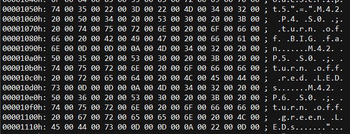

    when I export the repetier key, the export adds a CR to each line of code.
    problem exporting/importing registry keys 5b3f73d2-01e5-4dfa-b516-6663f2602851?upload=true.jpg
    If I import the reg file, it creates extra entries instead of the original single entry because of the extra 0D added.
    Therefore, I cannot backup my config and must recreate the whole thing.
    I believe at some point in the past I tried to remove the extra 0D s but because of the CF, LF in the data it still would not import properly.
    THIS has been a problem for a long time (as in b4 Windows 10) and so far no one has acknowledged it, or fixed it.
