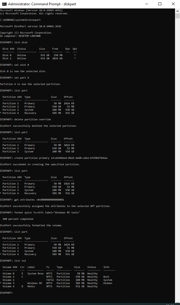

  2. Manually resize partition for KB5034441 not increasing recovery partition
    After encountering the KB5034441 update error I decided to use the following support article to increase the size of my windows recovery partition:
    KB5028997: Instructions to manually resize your partition to install the WinRE update
    I have followed the steps as described however my Recovery partition does not get any larger.
    I have:
    • disabled WinRE (not seen in the screenshot)
    • Shrunk the C drive partition (not seen in the screenshot but you can see the 250MB free space on the disk) in the first list disk call
    • deleted the previous Recovery partiton with 506MB
    • Created a new Recovery partition with attributes and formatted it
    But having completed all the steps my Recovery partition is still 506MB and the free space hasn't been reallocated so the update continues to fail.
    See my screenshot:
    Problem Resizing Recovery Partition 8l7wnkQD6pz6JZFN4KPz9LXkwMkC%2BqMsAAldZhb7%2BzKZTsa90hi3PcbAcnEqUaeGstD1OHkEhENTjRPtd9LklOh5c%3D.png
    I saw in a (timestamp 4:11) that if the C drive partition is not next to the Recovery partition then there are extra things that need to be done but I do not understand them.
    Can someone help guide me through?
    PS I don't actually know what the purpose of partition 3 is. In disk management it is called EFI System Partition so I assume it is necessary and I have worked around it.
    CDR Asmodeus, Jul 22, 2024

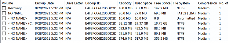

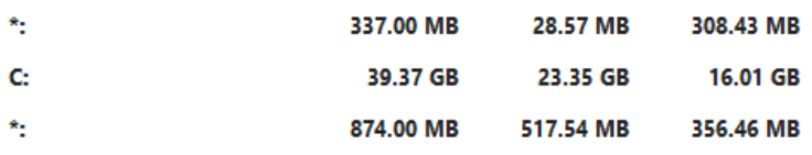

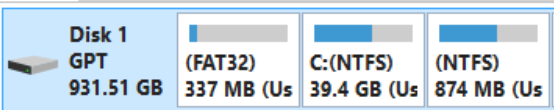

    Resizing the Recovery partition
    I recently restored a 1 /12 year old Macrium image that had seven OS related partitions
    Problem Resizing Recovery Partition 384435d1674851999t-resizing-recovery-partition-shrink-partition3.png
    I removed the redundant recovery partitions and extended the OS partition to incorporate the leftover empty space
    Problem Resizing Recovery Partition 384436d1674851943t-resizing-recovery-partition-shrink-partition.png
    Problem Resizing Recovery Partition 384437d1674852483t-resizing-recovery-partition-shrink-partition2.png
    I don't know what accounted for the size discrepancy, compared to the others, at the time that 874mb partition was created, but since it was the latest recovery partition, that's the reason I retained it in favor of the earlier ones. Everything seem to be working ok, but that partition has 365.5mb free space. Is there any harm shaving all or part of that free space off?
    kitpzyxmsir, Jul 22, 2024
