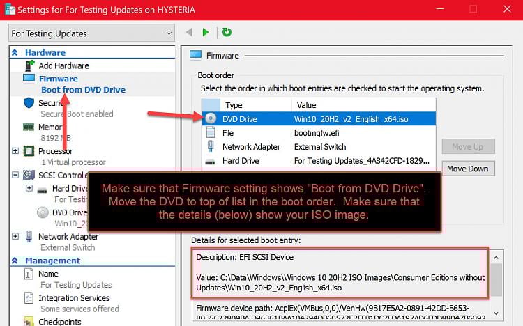

  3. Windows 10 autounattend xml installation problem
    Ok, that's a good start.
    Your answer file is made for a Gen 2 Hyper-V. It won't work on Gen 1.
    Verify the settings I have outlined in the image below:
    Problem with Win11 24H2 using autounattend.xml 311153d1608289003t-windows-10-autounattend-xml-installation-problem-image1.jpg
    NOTE: I have not looked at the answer file in detail. If you are still having difficulty, I'll look closer, but for now, time for sleep. It's 0500 here *Smile
    hsehestedt, Nov 12, 2024

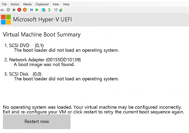

  4. radoslav Win User
    Hyper V gen2 configurations are like yours but when I start the VM I get that error:
    Problem with Win11 24H2 using autounattend.xml 311159d1608290410t-windows-10-autounattend-xml-installation-problem-fail.png
    I have done one more thing to the image, I loaded the image with NTLITE and there is an option explore mount directory basically there you can add a folder with files so when the image is installed for example you can have it in C:\CustomFolder with files and after that, with the program, you created the ISO file.
    radoslav, Nov 12, 2024
