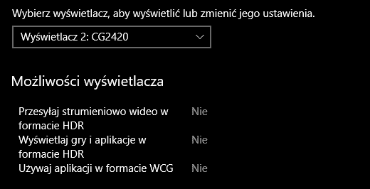

    Hi!
    I have problem with Eizo CG2420 and newest build of windows 10. After the update, there is new Tab inside Settings->System->Sidplay called Windows HD color. You can setup there if you want to use HDR or WCG of your monitor. The problem is that windows show that my monitor cannot show WCG and now in LR, photoshop or other software that uses color profiles colors are oversaturated - I can't use wide gamut profiles anywhere and I was using them with no problem 2 hours ago with previous build. It's in polish, but last option should be Tak (yes) instedof Nie (no). Is there a solution for that? Reinstalling drivers gave me nothing. Thank you for any help.
    Problem with Windows 10 (1809 build) and wide gamut monitor. 97db5274-31f6-4988-b2aa-3e0574630fd5?upload=true.png
    System: Windows 10 64b build 1809
    Graphics: GeForce 1060 with lates drivers
    Monitor: Eizo CG2420 with lates colornavigator
    Artur_Jarosz, Oct 3, 2018
