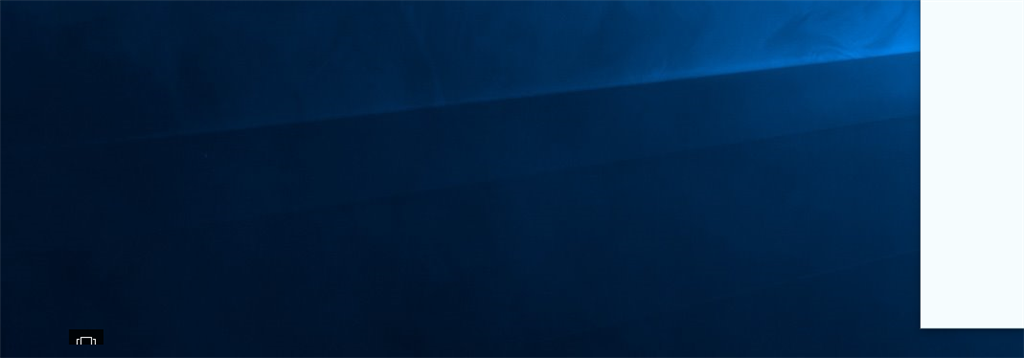

    Problems with Windows 10 Taskbar and Secondary Monitor
    On my secondary monitor, there is room for the task bar but the task bar is not displayed. (The task bar is displayed normally on the primary monitor.)
    Although there is no task bar on the secondary monitory, the top half of the Task View icon does appear on the secondary monitor at the location it would normally appear within the task bar.
    I'm uploading a screen capture from my secondary monitor. This is the very bottom left corner of the screen.
    Problems with my secondary monitor after windows update 21ef3c52-ee62-4321-b0a1-12931301cfdd.png
    Is anyone else seeing this issue? My computer is a newer Dell XPS 8700 with 32GB RAM.
    Jonathan B Wood, Nov 25, 2018
