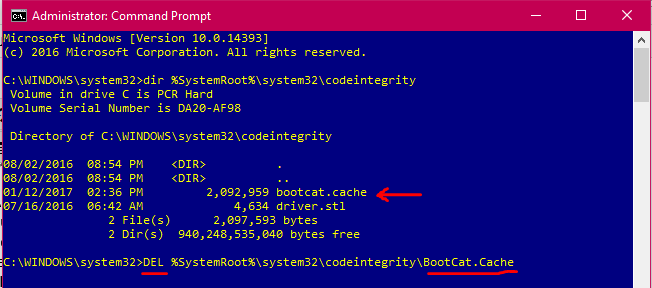

    It says to delete a file (which still exists in Win 10) named: %SystemRoot%\system32\codeintegrity\Bootcat.Cache
    Thus...
    DIR shows it exists. DEL would delete it. If it cannot be done while booted to Windows, then do as the article says & boot to a Rescue DVD or your Recovery USB drive ==
    OR == try to boot to your Recovery Partition this way: SHIFT+Restart.
    Then, at the "Choose an option" screen, select "Troubleshoot > Advanced Options > Command Prompt".
    Edit: I pulled that cure out of the thread...
    Redirecting
    PROCESS1_INITIALIZATION_FAILED Blue Screen STOP: 06B after System Mechanic defrag and restart.
    It's worth reading the entire thread. Also, there are multiple other threads for "process1_initialization_failed". BING it, if necessary.
