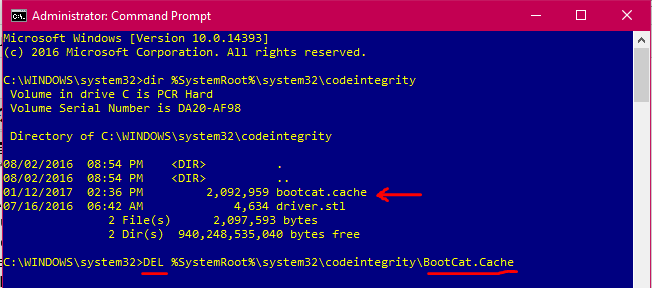

    So - it could be hardware or software at fault. Here is one thing to try...
    "Stop error code 0x0000006B PROCESS1_INITIALIZATION_FAILED" error message during startup on a computer that is running Windows 7 or Windows Server 2008 R2 - Microsoft Support
    It says to delete a file (which still exists in Win 10) named: %SystemRoot%\system32\codeintegrity\Bootcat.Cache
    Thus...
    DIR shows it exists. DEL would delete it. If it cannot be done while booted to Windows, then do as the article says & boot to a Rescue DVD or your Recovery USB drive ==
    OR == try to boot to your Recovery Partition this way: SHIFT+Restart.
    Then, at the "Choose an option" screen, select "Troubleshoot > Advanced Options > Command Prompt".
    Edit: I pulled that cure out of the thread...
