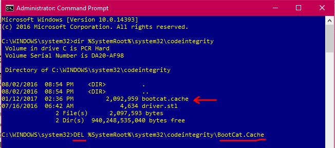

  4. PROCESS1_INITIALIZATION_FAILED
    Startup issue process1_initialization_failed
    Here is the official MSFT explanation...
    Bug Check 0x6B PROCESS1_INITIALIZATION_FAILED - Windows drivers
    Bug Check 0x6B: PROCESS1_INITIALIZATION_FAILED
    === Quote ===
    Cause
    Any part of the disk subsystem can cause the PROCESS1_INITIALIZATION_FAILED bug check, including bad disks, bad or incorrect cables, mixing different ATA-type devices on the same chain, or drives that are not available becuase of hardware regeneration.
    This bug check can also be caused by a missing file from the boot partition or by a driver file that a user accidentally disabled in the
    Drivers tab.
    === EOQ ===
    So - it could be hardware or software at fault. Here is one thing to try...
    https://support.microsoft.com/en-us...s-running-windows-7-or-windows-server-2008-r2
    "Stop error code 0x0000006B PROCESS1_INITIALIZATION_FAILED" error message during startup on a computer that is running Windows 7 or Windows Server 2008 R2
    It says to delete a file (which still exists in Win 10) named: %SystemRoot%\system32\codeintegrity\Bootcat.Cache
    Thus...
    DIR shows it exists. DEL would delete it. If it cannot be done while booted to Windows, then do as the article says & boot to a Rescue DVD or your Recovery USB drive ==
    OR == try to boot to your Recovery Partition this way: SHIFT+Restart.
    Then, at the "Choose an option" screen, select "Troubleshoot > Advanced Options > Command Prompt".
    Edit: I pulled that cure out of the thread...
    https://answers.microsoft.com/en-us...stop-06b/18250508-4ef2-4ddd-9599-ee1b11e32a32
    PROCESS1_INITIALIZATION_FAILED Blue Screen STOP: 06B after System Mechanic defrag and restart.
    It's worth reading the entire thread. Also, there are multiple other threads for "process1_initialization_failed". BING it, if necessary.
    PCR Just PCR, Nov 16, 2020
