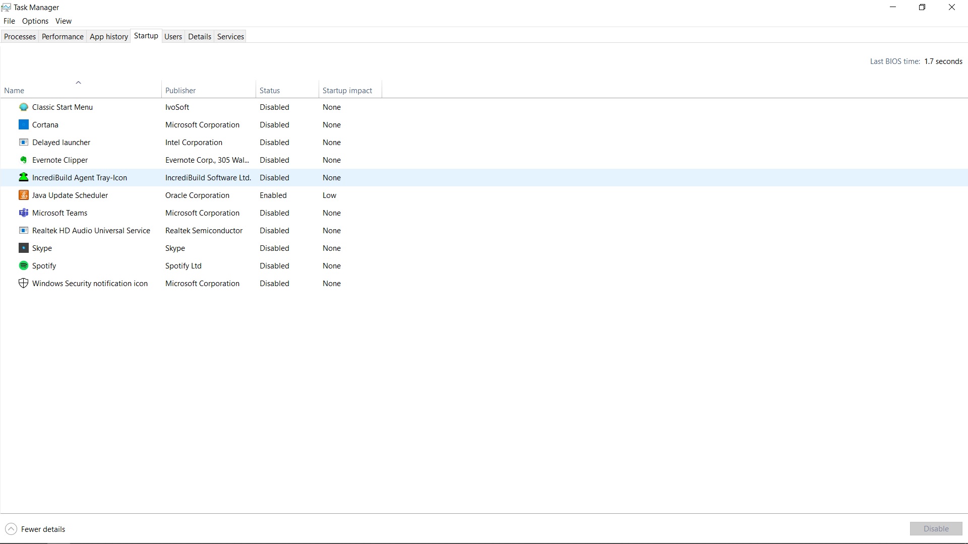

  1. program icons left in system tray after programs are closed and technically are terminated
    can any of you guys explain why this happens with almost every program on a windows machine?
    https://www.bleepingcomputer.com/forums/t/735511/ccleaner/
    I've always had the same issue and all of my programs that are thrown into the startup dir when installed have been disabled. see image below. help anyone?
    program icons left in system tray after programs are closed and technically are terminated fc53c723-ee7e-42e1-9a0c-89312da9f9a0?upload=true.jpg
