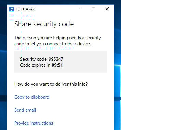

    Quick Assist support - timer for give asisstance set at 0
    Is this the screen you are talking about?
    Quick assist application - request is not supported 7d1541268393t-quick-assist-support-timer-give-asisstance-set-0-a-qa_seccode-100684901-large.idge.jpg
    Try repairing Quick Assist.
