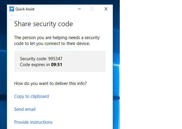

    Quick Assist support - timer for give asisstance set at 0
    Is this the screen you are talking about?
    Quick assist application - request is not supported 7d1541268393t-quick-assist-support-timer-give-asisstance-set-0-a-qa_seccode-100684901-large.idge.jpg
    Try repairing Quick Assist.
    1. Press Windows key + i to open Settings.
    2. On Settings, choose Apps & features.
    3. On the left pane, choose Programs and Features.
    4. Then, look for Quick Assist and click on it.
    5. Choose Advanced options, then Repair.
    You could try uninstalling and reinstalling Quick Assist again, see if that helps.
