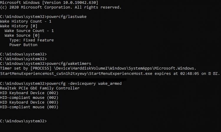

    As per the advice from steve108 in this post on this link https://www.hellotech.com/blog/why-does-my-computer-keep-waking-from-sleep-mode I followed the steps under the section 'How to Find Out What’s Causing Your Computer to Wake Up'
    I ran powercfg from an elevated command prompt.
    powercfg/lastawake was no help as it showed the power button which I used to turn the pc on this morning (!)
    If this happens again (pc wakes from sleep), I'll have to leave it on and then run the powercfg/lastawake command
    powercfg/waketimers is puzzling as it shows the hard disk volume 2 as the culprit.
    I have no idea what 'StartMenuExperienceHost' is but it looks like ONG's suggestion of looking in the Startup programs and Background Apps may bear fruit.
    powercfg -devicequery wake_armed shows two entries for both the mouse and keyboard. Both now disabled.
    Command Window:
    random freezes and lockups 307185d1605862126t-random-freezes-lockups-ssd-issue-powercfg.jpg

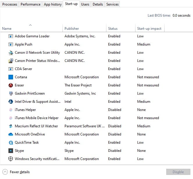

    Startup Programs/Apps as follows:
    random freezes and lockups 307184d1605862091t-random-freezes-lockups-ssd-issue-startup-programs.jpg
    I'm thinking I don't need the following to be enabled?
    Adobe Gamma Loader
    Apple Push
    Cortana
    Eraser
    Intel Driver and Support Assistant
    Quick Time Task
    However some advice/confirmation would be great.
    CDA Server (Part of Samsung Easy Printer Manager) for a wireless networked AiO Printer and as such should be running? Apparently, an obsolete or defective version of CDASrv.exe can cause problems

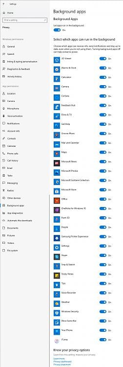

    There were 31 'Background Apps' that were turned ON.
    List follows:
    random freezes and lockups 307187d1605863480t-random-freezes-lockups-ssd-issue-background-apps.jpg
    Apart from, perhaps, Windows Security and maybe iTunes, is there any reason for any of these to be on?
    For example, I don't use One Note, Skype nor the Xbox Game Bar (I'm not a gamer) so I'm confident in turning those off (inded I already have).
    Are there any that I really NEED to be running in the background - e.g Get Help and Office?
    At the moment, Get Help and Office, Settings, Windows Security and iTunes are the only ones that I have leftswitched on.
    Help/suggestions as to whether (or not) I need these apps running in the background are most welcome.

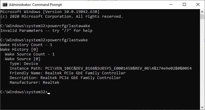

    Straight after my last post I put the pc to sleep.
    Within about 5 mins it woke again and my wife sais 'Have you got something running on the computer because it has just turned itself on"
    So I ran powercfg/lastwake and this is what it showed:
    random freezes and lockups 307871d1606255044t-random-freezes-lockups-ssd-issue-powercfg-2-.jpg
    So it IS the Realtek PCIe GbE Family Controller that is waking the pc.
    Now to find out where the specific setting is and how to turn it off.
    Any ideas folks?
    Cheers,
    Art

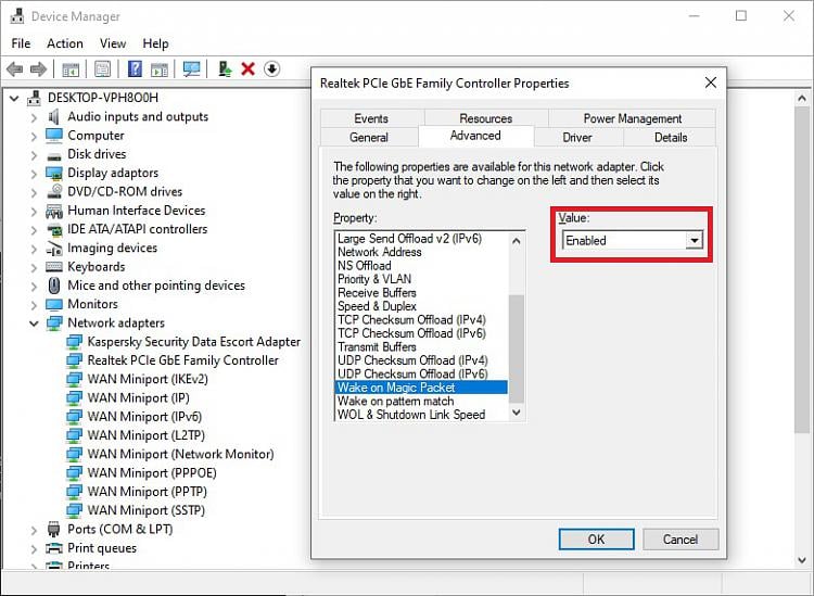

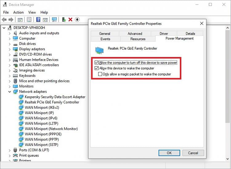

    Okay
    I found the following in the Network adapter Properties ...
    random freezes and lockups 872d1606255487t-random-freezes-lockups-ssd-issue-realtek-pcie-gbe-family-controller-properties-1.jpg
    and
    random freezes and lockups 873d1606255503t-random-freezes-lockups-ssd-issue-realtek-pcie-gbe-family-controller-properties-2.jpg
    Taken the tick (check mark) out of the '"Allow this device to wake the computer" box.
    I left the "Wake on Magic Packet" enabled (since clearing the above greys out the 'Only allow a magic packet to wake the computer' box).
