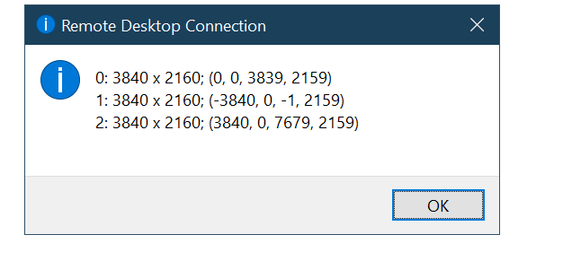

    Multiple Monitors in RDP ?
    Hi folks
    @ugo21
    @NavyLCDR
    Try this :
    As always Windows documentation (contradiction in terms !!!) always hides good bits
    Save your RDP file, and open it in Notepad. Everyone's RDP file is different but yours may look like this:
    full address:s:x.x.x.x:3389
    prompt for credentials:i:1
    administrative session:i:1
    screen mode id:i:2
    span monitors:i:1
    use multimon:i:1
    selectedmonitors:s:0,1
    To get a list of monitors, run mstsc /l to LIST out all the monitors. You can also use mstsc /multimon as a command line to use multiple monitors.
    So for example :
    RDP:  If I save .rdp files with different users for the same target, it will log in with... 314534d1610617078t-multiple-monitors-rdp-multimon.png
    job done !!!
    Cheers
    jimbo
