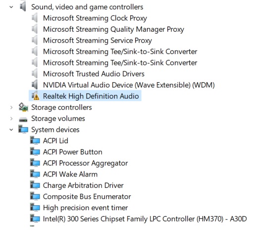

    Hi.
    Yesterday, I tried letting the program Driver Booster by iObit update my drivers while I was out walking my dog because everyone I know had recommended it. When I came back and restarted my laptop, I suddenly had no audio.
    I subsequently spent 9 hours going through every single fix I could find here or anywhere else on the web.
    I tried everything from reinstalling & updating the driver, delete it completely and set up a generic audio driver. Tried to reset the audio service, even resetting the registry.
    Realtek & HD Audio drivers not found/not working db43fd0d-54b1-43ec-a5a3-c2dc763b9e45?upload=true.jpg
    On top of all of that, I also seem to be missing High Definition Audio Driver. And I can't seem to "get them back".

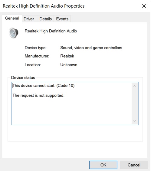

    The only reason I currently even have the Realtek driver visible in my Device Manager is because I used Device Manager's "Add Legacy driver" setting to at least have it be visible on my screen, since doing so gives me a Code 10. I did this because downloading and installing the driver, from either Realtek's own website or Lenovo's page for my type of laptop would download, install and say that the installation was completed successfully, but nothing happens even after a restart.
    Realtek & HD Audio drivers not found/not working 567671f2-0a29-47cd-9378-0584655de430?upload=true.jpg
    After everything I tried, I also did a complete windows reset.
    ... Nothing!
    My laptop is an Ideapad L340-15IRH Gaming
    Bios version is: BGCN33WW
    Processor IntelR CoreTM i5-9300H CPU @ 2.40GHz 2.40 GHz
    Installed RAM 8,00 GB 7,88 GB usable
    System type 64-bit operating system, x64-based processor
    I have no more ideas for what to do next. I've tried everything I know and everything I could find.
    Any other ideas?
    AhmadZubir, Mar 19, 2021
  2. JoeBoyka Win User
    The Ultimate Realtek HD Audio Driver Mod for Windows 10
    Everything is working *Smile Realtek & HD Audio drivers not found/not working :)
    JoeBoyka, Mar 19, 2021
  3. Jayce Win User
    I had the realtek error when using the installer, so I did these step and It Worked
    1.Go Open up device manager
    2. Go under sound,video, and game controllers
    3. Find Realtek High Definition Audio
    4. Right click and hit update driver
    5. Browse my computer for driver software
    6. Let me pick from a list of available drivers on my computer
    7. Click Have Disk and hit browse
    8. Click on the Realtek HD Audio mod folder and look for win64
    9. Click on the HDXRT4 and click ok,
    10. Click Next and Yes
    After it is done, restart the PC
    You should be good then and also make sure before doing these steps that you have driver enforcement disabled.
    Jayce, Mar 19, 2021
  4. Jayce Win User
    Everyone that post ids, need just do these steps and you will be good. I kinda tired of keep on uploading the inf. file
    additional if you want dts audio and others, install it now before next step.
    Jayce, Mar 19, 2021
