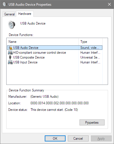

  4. Nearoo Win User
    RealtekR Audio This device cannot start. Code 10
    Windows 10: USB Audio device "cannot start (Code 10)"
    I just bought a RadioShack Microphone Adapter 33-331. It's a XLR to mini USB converter. Supposed to be plug-and-play, but sadly doesn't work.
    The device gets recognized as an audio device, however, when checking the properties of the device in the "Devices and Printers" dialogue and then clicking on Hardware, I get "This device cannot start. (Code 10)" from one of the components:
    Here are some steps I tried that you might try as well if you have a similar problem:
    Nearoo, Feb 29, 2024
