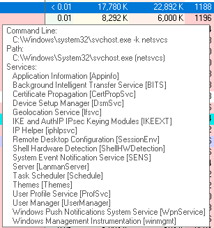

    Which seems to be a list of "netsvcs" for Windows. Opening the dump from the svchost.exe and looking at this a single thread was found with an interesting call stack:
    UBPM is the Unified Background Process Manager. But how can this be terminating our application? And why? And what does the termination code 1067tell us?

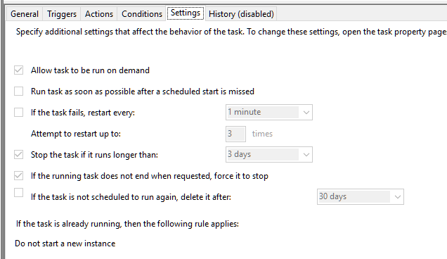

    UPDATE 2: We use the nuget package TaskScheduler to setup the task via code. Note we do not set the ExecutionTimeLimit, which should therefore be Nothing and hence infinite.
    UPDATE 3: Perhaps the above statement was wrong, the default in the TaskScheduler library seems to be 3 days or 72 hours.
    UPDATE 4: Only thing is we observe silent process exits after the process has been running for much longer than 3 days, e.g. 30 days so not sure it is this after all.

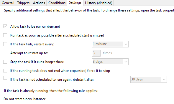

    UPDATE 5: The longer than 3 days was not correctly observed, so after everything it is now clear this was due to incorrect settings for the task scheduler task. The wrong settings shown below:
    Reason Code: 0x50006 The system process 'C:\WINDOWS\system32\lsass.exe' terminated... 5tqwS.png
    Correct settings being:
    Reason Code: 0x50006 The system process 'C:\WINDOWS\system32\lsass.exe' terminated... e9PF8.png
