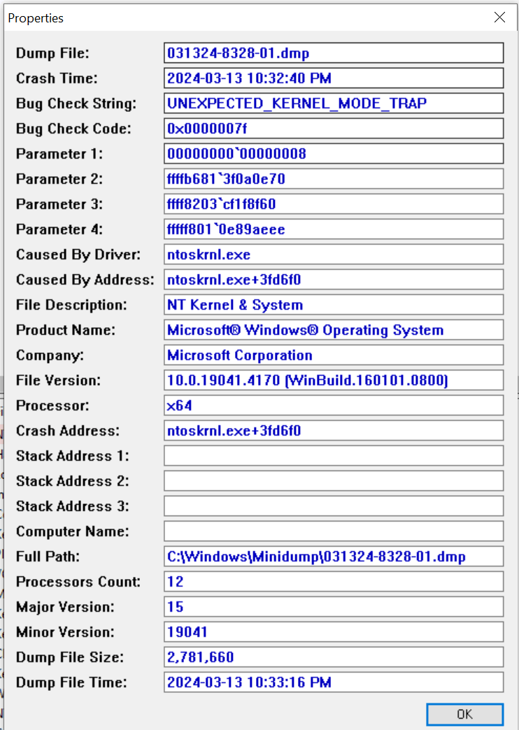

  1. Recently built a PC from all new parts except GPU. Now I suffer daily BSoD with various codes.
    I now am seeing tons of BSOD failures. I reinstalled windows hoping this would fix the problem. I now see that it hasn't, so I present the following minidump. If anyone can deduce the point of failure from this info I will be forever in your debt.
    Hayden Brent Holdsworth, Mar 17, 2024
  2. Recently built a PC from all new parts (except GPU). Now I suffer daily BSoD with various codes.
    Hi Hayden,
    My name is Igor, it's a pleasure for me to help others and I'll try to help you.
    Different BSOD codes usually mean hardware problems unfortunately. Please start with memory testing using Windows memory diagnostic tool and switch it to extended mode when it starts (F1 key). Note, test hang at ~21% for more than 3-5 hours means memory error too.
    Turn off XMP mode in BIOS if it is turned on.
    And please check your RAM modes (voltage, frequency, timings) are in compliance with numbers in the motherboard compatibility list for your RAM model.
    beginner level.
    P.S. This is not minidump unfortunately, just a kind of analysis of starting level.
    Igor Leyko, Mar 18, 2024
