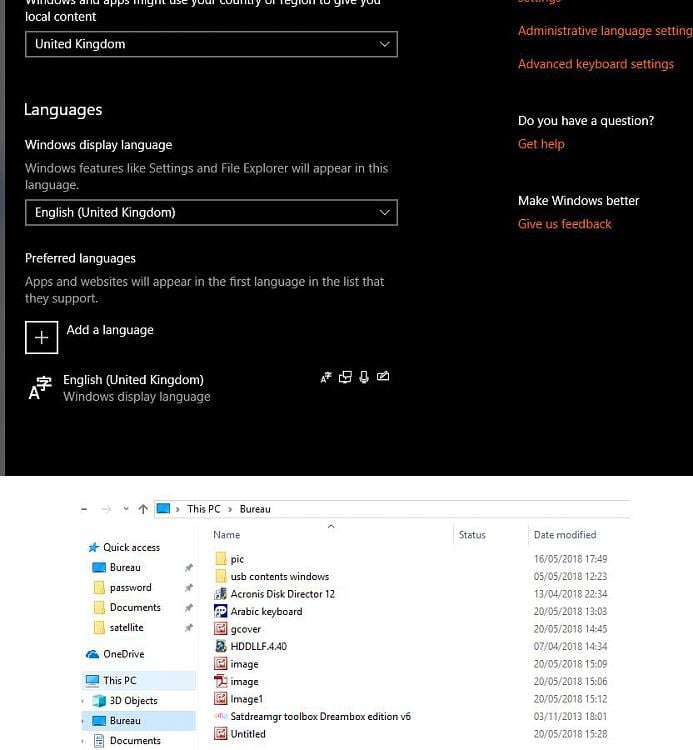

    I have done what you have suggested although I couldn't find the Arabic keyboard to add anyway I have added the French keyboard then removed all the languages and restarted
    it booted with a message configuring update but the word bureau still there.
    recuperation du bureau 189547d1526827426t-desktop-changed-bureau-mergedobject1.jpg
    gremar, Dec 3, 2024

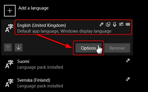

    OK. The good thing is you have only added French and Arabic but not installed the language packs. Please try this:
    1.) Select your display language (English UK), click Options:

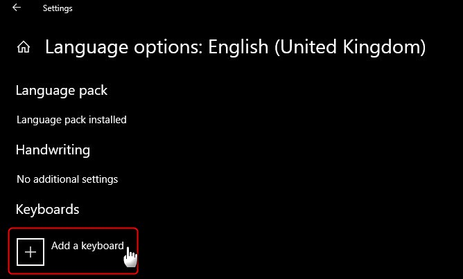

    2.) Select Add a keyboard:

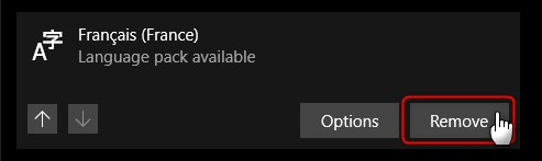

    5.) Go back to Region & Language page, remove both French and Arabic languages:
    6.) Restart, check if File Explorer Quick Access is still showing Bureau or if it has been changed to Desktop
    That's it for now. Post here to tell what happened before we re-add French and Arabic languages.

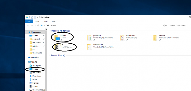

    Hello, The name of desktop has suddenly changed to bureau
    It has been like this for sometimes now and is causing me a lot of problems, no application recognise bureau. How to rename it or take back to its proper name
    Thank you
    gremar, Dec 3, 2024
