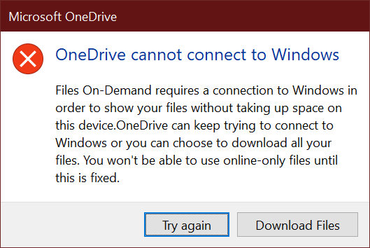

    I've been facing this issue for months, and a long thread with Microsoft Support brought nothing but "we have escalated this to the product team."
    Quite frequently (say at least once a week) I get the following error:
    Recurring "OneDrive cannot connect to Windows" problem, need to restart system every time... ead81359-71e4-46d0-9e28-3525cf99269a?upload=true.png
    "Try again" only brings the same message box after a few minutes.
    I'm aware of this article but the filter driver is up and running when I get the error:
    PS 7.0.0-preview.3 C:/Users/steph> get-content 'C:\Users\steph\OneDrive\Documents\PowerShell\Modules\Microsoft.PowerShel
    l.GraphicalTools\0.2.0\PSGetModuleInfo.xml'
    get-content : The cloud file provider is not running. : 'C:\Users\steph\OneDrive\Documents\PowerShell\Modules\Microsoft.
    PowerShell.GraphicalTools\0.2.0\PSGetModuleInfo.xml'
    At line:1 char:1
    + get-content 'C:\Users\steph\OneDrive\Documents\PowerShell\Modules\Mic ...
    + CategoryInfo : ReadError: (C:\Users\steph\OneD…PSGetModuleInfo.xml:String) [Get-Content], IOException
    + FullyQualifiedErrorId : GetContentReaderIOError,Microsoft.PowerShell.Commands.GetContentCommand
    PS 7.0.0-preview.3 C:/Users/steph> sc.exe query cldflt
    SERVICE_NAME: cldflt
    TYPE : 2 FILE_SYSTEM_DRIVER
    STATE : 4 RUNNING
    (STOPPABLE, NOT_PAUSABLE, IGNORES_SHUTDOWN)
    WIN32_EXIT_CODE : 0 (0x0)
    SERVICE_EXIT_CODE : 0 (0x0)
    CHECKPOINT : 0x0
    WAIT_HINT : 0x0
    Restarting the system restores normal operation… until the next occurrence.
    This affects at least two of my systems, including a brand new Dell laptop I purchased less than 2 months ago.
    I've tried enabling the "OneDrive Insider Preview updates", to no avail.
    Is anyone from Microsoft listening? I know I'm not alone with this problem, and we desperately need a fix--having to restart your machine in the middle of a meeting or presentation is just not acceptable...
