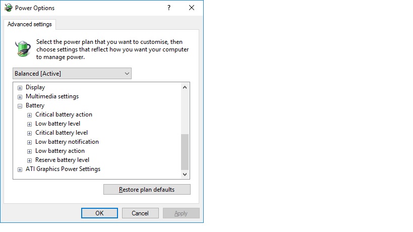

    Following running the above, I have had a look what is available within the 'Power Options' dialog box for the 'Balanced' power plan. The
    following screenshot shows what I have now;
    Remove Critical battery notification from Power Options in Windows 10 44e541d8-1b16-4e0a-908c-34e5fc7d922b.jpg
    As you'll see from the above screenshot, I only have a 'Low Battery Notification'.
    Would you be able to advise on how I get the 'Low' or 'Critical' battery notification?
    Many thanks in advance,
    Neil
    Neil Hobbs, Oct 27, 2019
