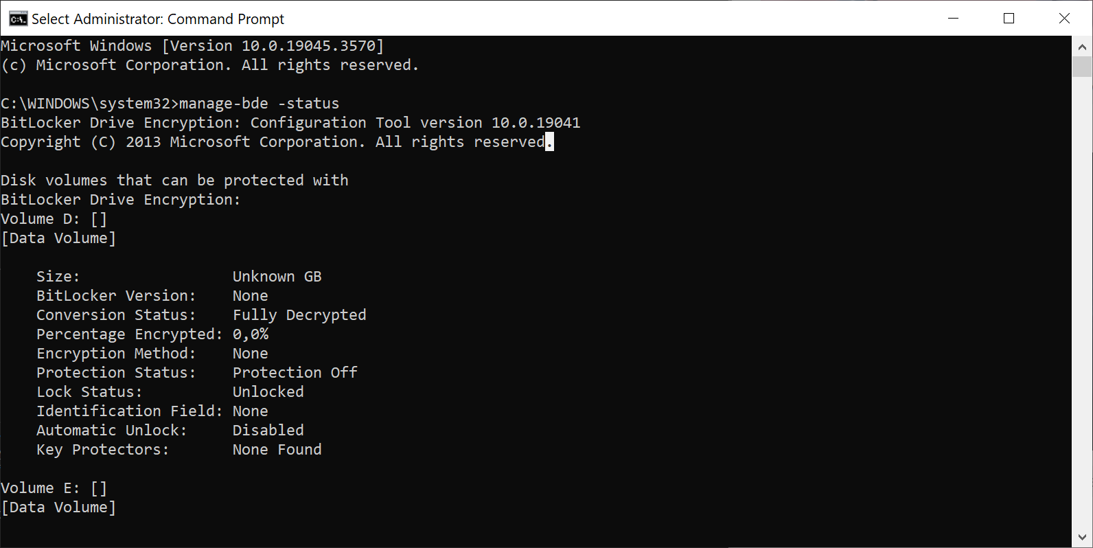

    Find out if BitLocker is enabled
    Report: BitLocker slowing down SSDs on Windows 11 by up to 45% no-bitlocker.png
    First thing that Windows 11 Pro users may want to do is check if BitLocker is enabled on their devices. This can be done with a single command from an elevated command prompt:
    1. Open Start on the device.
    2. Type cmd.exe.
    3. Select "Run as administrator" to launch an elevated command prompt window.
    4. Paste the command manage-bde -status and press the Enter-key.
    5. The command returns the status for all connected volumes.
    Protection Status tells you if BitLocker encryption is enabled (On) or not (Off). If it is enabled, check the encryption method used. If you see "XTS-AES" there, software encryption is used.
