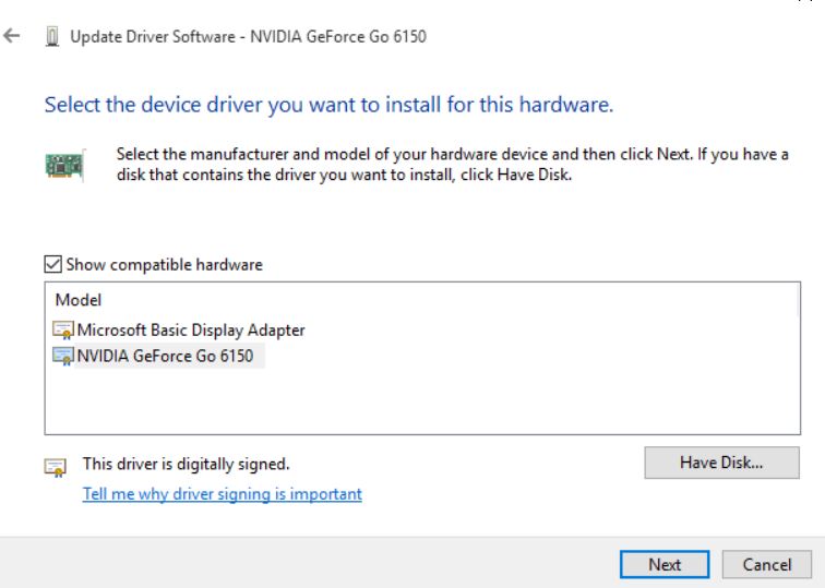

    > Browse my computer for driver software, Locate and install driver software manually
    > Let me pick from a list of device drivers on my computer
    > Select NVIDIA GeForce Go 6150 from Select the driver you want to install for this hardware. Please see the attached screenshot.
    Resolution messed up after new Nvidia geforce graphics update bed1b3de-9683-4a61-8a8e-f00f3c047f50.jpg
    Complete the installation and restart the Laptop.

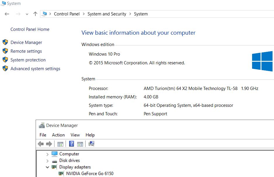

    Go to Windows 10 Settings >Display > Advanced Display Settings > Select resolution Recommended (example 1280 X 800 )
    If the text on screen is small then goto Advanced sizing of text and use custom sizing to 125 %.
    Finally NVIDIA GeForce Go 6150 Graphic Card working on Windows 10.
