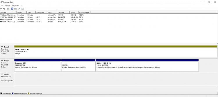

    here the dump of Disk Management
    Dropbox
    Emanuele Manco, Apr 16, 2025
