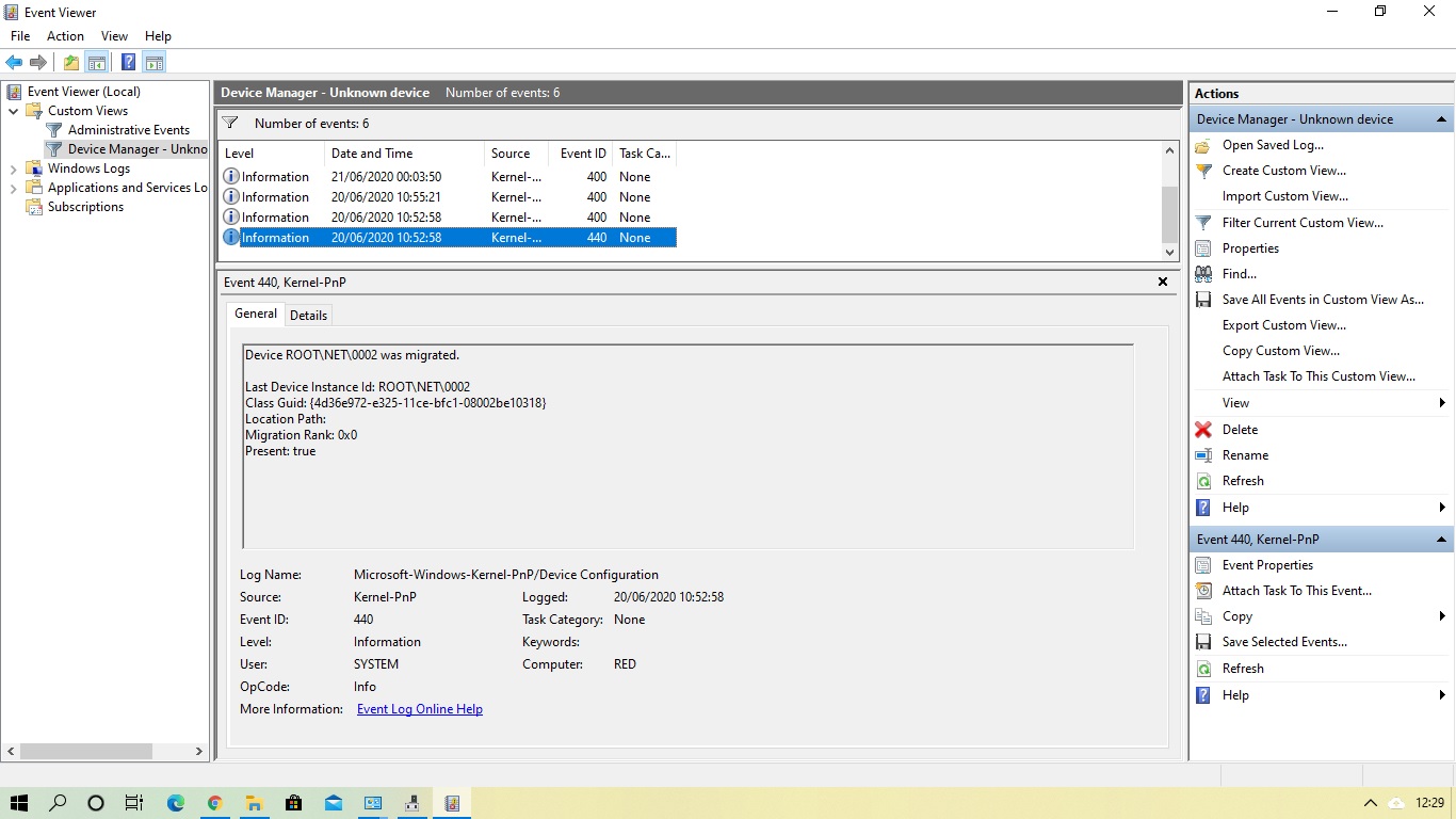

  1. ROOT\NET\0002 error on TAP-windows adapter v9
    Hi, This problem started about five days ago.I ran my vpn to connect to the internet I use vpn because of the censorship policies of the foreign country I work for to be able to use sites like youtube, twitter , etc. but an error was shown: "failed to initialize vpn adapter." I reinstalled the vpn, used an updated version, updated adapter drivers in device manger but nothing changed the error. Then I checked the event log of the TAP windows adapter v9. At the last row it shows: "device not started." In the information box it says:" Device ROOT\NET\0002 had a problem starting.Driver Name: oem
    HamedGhazizadeh, Dec 2, 2021
