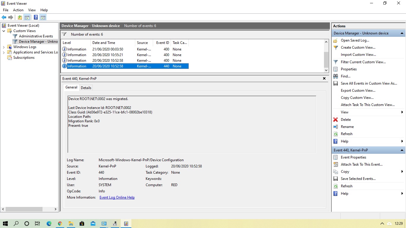

    my laptop error ROOT\NET\0002
    but sercing driver can not found in microsoft update
    please help
    ROOT\NETalt=
    JimmyGunawanTJ, Dec 2, 2021
