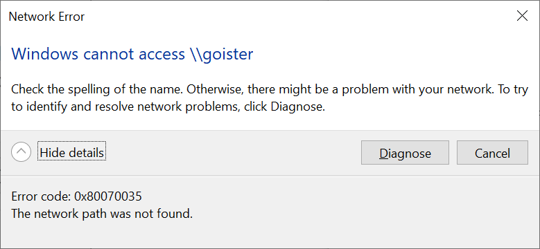

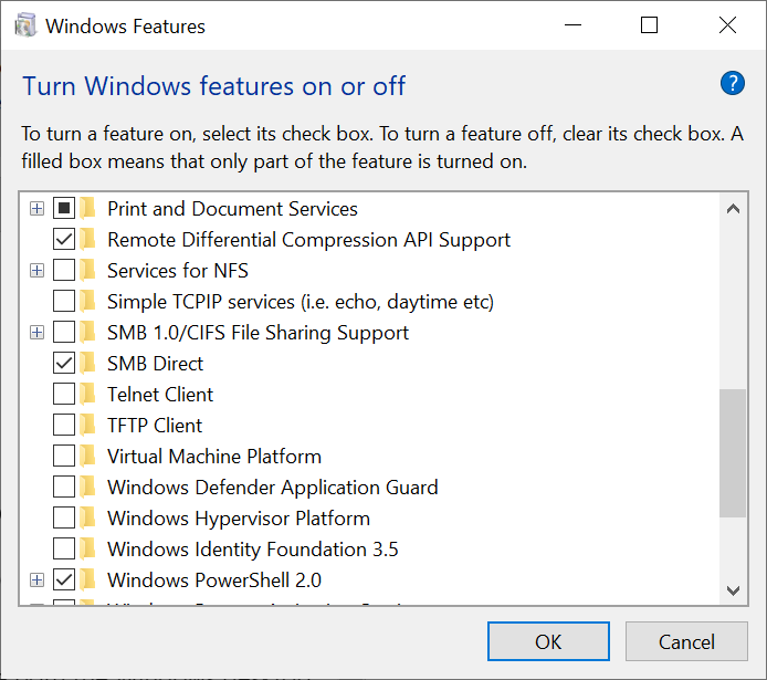

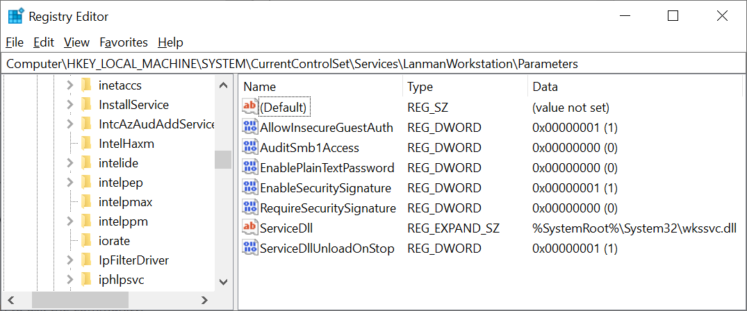

  4. scorcho Win User
    Samba SMB2 SMB3 not working
    How to user SMB2 on Windows?
    I have a problem accessing my Synology DS218J NAS from my Windows 10 desktop. I get the following error when I try to access it.
    Samba SMB2 SMB3 not working b96c7d5f-e06c-41c2-a5c2-ab1250a5c103?upload=true.png
    The NAS is working fine, as I can access the web portal from the same desktop. I can also access the NAS from other laptops and mobile devices.
    I tried using a Linux VM to connect to the NAS via smbclient: "smbclient-U galapogos -L <host>" and I get the error "protocol negotiation failed: NT_STATUS_INVALID_NETWORK_RESPONSE"
    After googling on the Windows/Linux error codes, it seems to indicate a SMB1 error, but I didn't think it would be because both the Windows desktop and the NAS have SMB1 disabled.
    But, just to confirm, I tried to force SMB2/SMB3 on Linux via smbclient: "smbclient -m SMB2/SMB3 -L <host>" AND BOTH SMB2/SMB3 WORKED!
    So, it does seem that Windows is not using SMB2/3? How do I force it system wide? Or, is there an smbclient on Windows that I can try to use to confirm the problem?
    I've already disabled SMB1 in Windows Features.
    Samba SMB2 SMB3 not working d933d472-e360-426c-b676-49446b50e883?upload=true.png
    I've also disabled it in the registry via PowerShell commands and verified that it's not there in the registry.
    Samba SMB2 SMB3 not working c1d396c6-df2a-4783-aa0d-3abb0ef0666f?upload=true.png
    So, does anyone know how to FORCE Windows to use SMB2/SMB3 like I can with smbclient in Linux?
    scorcho, Sep 29, 2024
