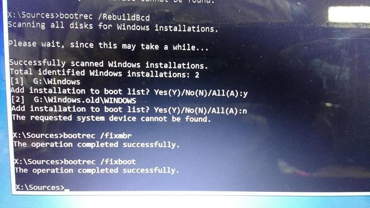

    i tried the manual repair option, I got the following.

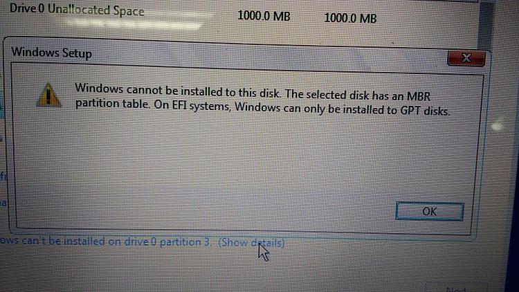

    I also tried to do a reinstall of windows, just in case to check. I couldn't install Windows on any of the drives, I got the following error. I am not sure what the error is, But I haven't done any formatting recently. I had upgraded from windows 7 directly. Why am I getting this error? Is it related to the boot error?

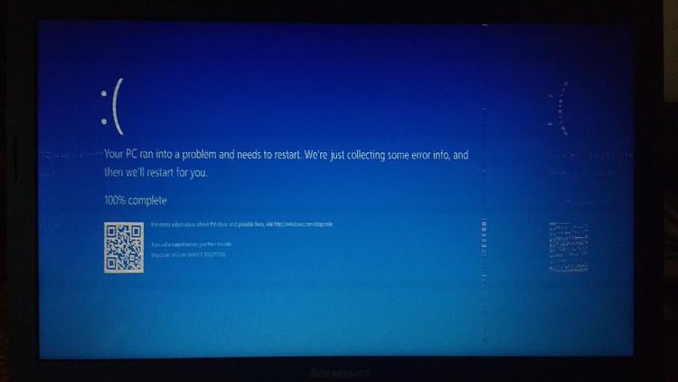

    I was working on my laptop (Lenovo G505s, AMD A10, 10gb Ram, 1Tb HDD, Win 10 edu), suddenly I got a Blue screen error and Windows started collecting data regarding teh error. It went till 100% and got stuck there, after some time the screen started getting distorted, black horizontal lines started coming on screen. I power offed the PC using the power button.
    After that I am not able to boot in to my PC. My HDD is being detected in BIOS, I can read the contents if I connect it via a SATA to USB adapter on a Windows PC (But not on an UBUNTU PC) but my HDD is not shown in the boot manager. I am getting an error saying that "No Bootable Media Detected, Please Restart"
