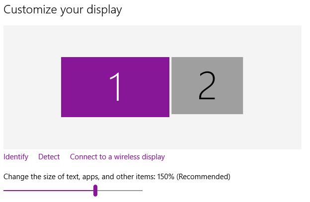

    1. The simplest way to change the scaling is to right click on the desktop and choose display settings.
      As shown in the screenshot, the slider only allows for increments of 25%, and I need scaling in between 125% and 150%
