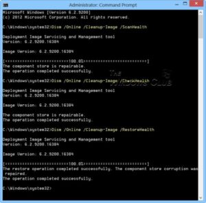

Discus and support SFC not working, will not run or could not repair corrupt file in Windows 10 News to solve the problem; [ATTACH]The System File Checker or SFC is a system tool that can allow users to scan for and restore corrupt Windows system files. It is […] This... Discussion in 'Windows 10 News' started by WinClub, Sep 2, 2020.

    My Surface Pro 4 does not appear to have any problems. But I periodically run System File Check. SFC now reports corrupt files that it cannot repair. I've tried running DISM using the basic restorehealth options. This never has worked without downloading
    a fresh .iso copy of Windows, which is no longer available for download. I even tried the DISM from the repair environment. It ran successfully, but SFC still reports corrupt files that it cannot repair. What should I do? I don't want the Windows OS files
    on my Surface to be corrupt. From the number of posts on this forum, this must be a common problem. None of the threads I've read suggests anything that I haven't already tried. As I said above, most of the suggestions involve running DISM without referring
    to an ISO file. That's strange, since I've never seen that work.

    Hi Jay,
    For to better assist you with the SFC reports issue, we'd like to know the following:
    • Have you installed any Windows updates prior to this issue?
    • Please provide us a CBS logs for us to determine what is the file that cannot be repaired.
    To get the logs, please follow the steps below:
    • Open a Command Prompt (Admin).
    • Copy and paste findstr /c:”[SR]” %windir%\Logs\CBS\CBS.log >”%userprofile%\Desktop\sfclogs.txt”, then hit
      Enter. (This will create a sfclogs.txt file on your desktop).
    • Open the sfclogs.txt and check the result of SFC scan.
    Note: SFC cannot always fix corrupted files.
    We're looking forward to your reply.
