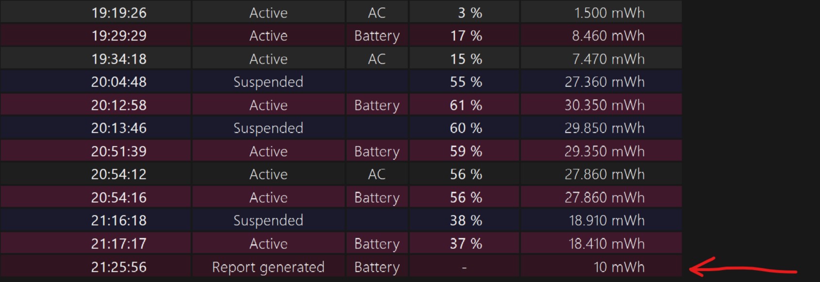

    Battery percentage jumps erratically on an 8 month old Lenovo Y720 laptop
    My laptop has been acting very strange the last few weeks. It is about 8 month old.
    I have conservation mode turned on, which means it does not charge above 60%. However lately when I am using it, it will go down to about end thirties (like 39%) and suddenly begin to turn off, not turn off immediately but like when it goes into sleep mode. Then I plug in the charger and the battery is suddenly 0%, fully drained.
    So it jumps from around 40% to 0% in an instant. Uptime is usually around 1 hour and 10 minutes on battery, where it normally would be above 2 and a half hours. If I only charge the battery to something under 40%, like 15%, it will not turn off.
    I have made a battery report in windows, notice how at the end today it is 37% then suddenly it turns off.
    The report is very long so I took a picture of the important part.
    should a month old laptop have a drop in battery capacity like this.-- P2RQk.jpg
    OBS:
    The report also says that the design capacity is 57.000 mWh and current capacity is 49.740 mWh
    rangaha fasola, Aug 3, 2023
