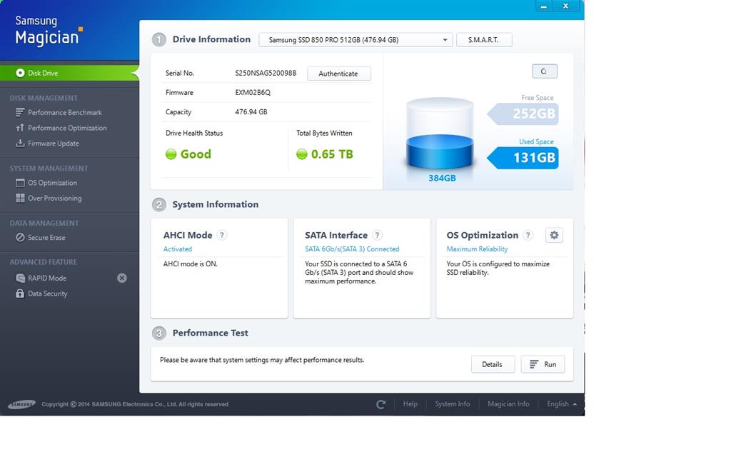

    The SSD software, Samsung Magic, is saying:
    …and…
    In the device manager, there is:
    …and also…
    D_777, Dec 20, 2020
