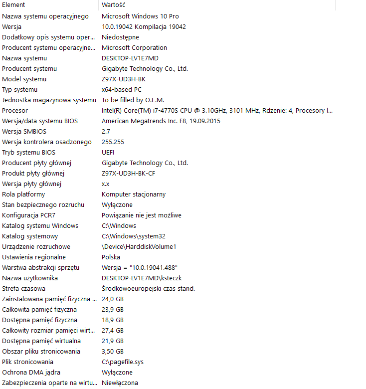

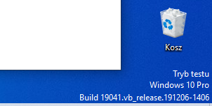

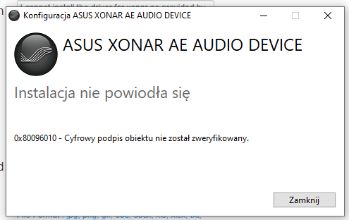

    I'm trying to install the driver for asus xonar soundcard, and windows reports an error that the digital signature of an object could not be verified
    Signature verification failure of a driver when installing the driver, even if the driver... 2ed1fda4-f0e9-466f-b14c-3d2c98f31fc7?upload=true.png
    The solution to this issue, proposed by asus here:
    An error message about digital signature pops up when installing driver of audio card and headset after latest Windows Update | Official Support | ASUS Global
    suggests disabling requirement for digital signature for the drivers and installing the driver, which is ridiculous but nevertheless I gave it a chance in order to make my card working. However I can't disable Driver Signature Verification. I worked all
    solutions from there:
    https://www.tenforums.com/tutorials...river-signature-enforcement-windows-10-a.html
    and after none I was able to install that. And the option Startup Settings at Boot don't change anything. How can I do that? Pasting info about my OS and hardware:
