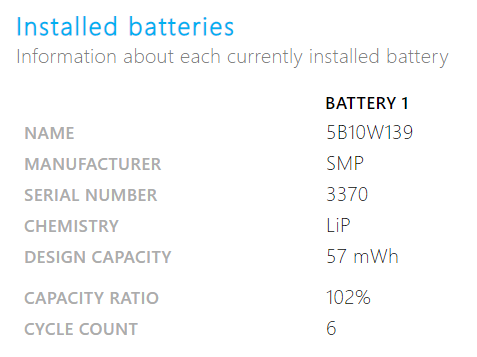

    Hello! Does anybody know why the powercfg sleep study does not display any of the % of battery?
    Here's how it looks like:
    Sleep Study not showing % of battery 328cf7a9-83dc-4cd0-8051-446b305e09fe?upload=true.png
    The report was generated with powercfg /SleepStudy /output "C:\sleep_report.html".
    I'm running a brand-new ThinkPad T14s / AMD Ryzen 7 and I am trying to figure out why the modern standby is consuming a lot of battery. Since the percentages are missing, I wonder if the rest of the sleep report is accurate.
    It seems that the battery is properly detected by the system:
    Sleep Study not showing % of battery ce9f281b-053d-4126-8209-f7bb6b885a51?upload=true.png
    Any help would be appreciated. Thanks!
    P.S. Using S3 sleep instead of modern standby is not an option either, as the audio driver fails to initialize after waking up, so I need to figure out what's draining the battery during S0 :
    BogdanPopescu4, Oct 13, 2020
