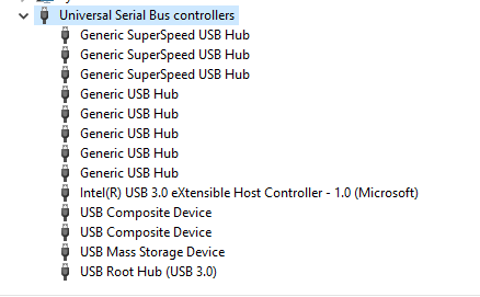

    I have:
    Slow speed transfer USB 3.0 on Windows 10 c91111bb-0147-40d0-a2bb-280404b8af36?upload=true.png
    Which of these do I uninstall?
    saberman, Oct 26, 2023
